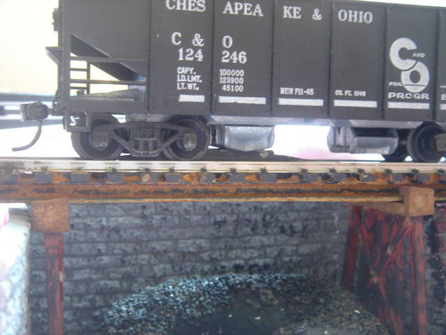

The retaining wall at the back of this coal dump bin is a Hydrocal casting.
This is a curved wall also made with Hydrocal, with a different mold.
I bought these molds from Dave Frary. He has since gotten out of the business. I think Sterling Models carries them now.
