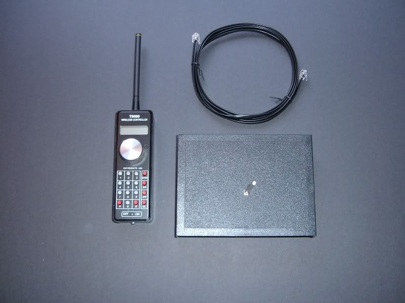

Here’s the T9000E throttle, ALR900 Receiver and a 7’ long, 6 conductor DATA cable with RJ12 plugs. The antennas ship loose for protection:
http://i67.photobucket.com/albums/h309/jwils1/DSCF0990.jpg
http://i67.photobucket.com/albums/h309/jwils1/DSCF0991.jpg

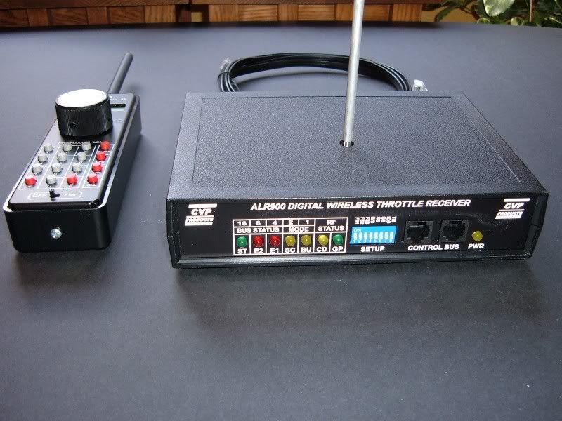

The Receiver settings are simple and quick. Just set one switch and plug into the ExpressNET and you’re ready to go.
The T9000E is a little smaller than the Lenz LH100. It’s easy to handle, has a nice weight and feel, and I quickly learned to operate it with one hand, although think it’s a little more comfortable to operate with two hands. But when a free hand is needed for
