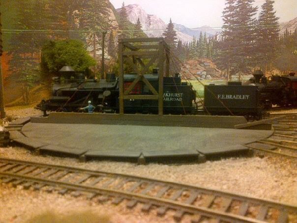

Thanks. My ebay purchase (made after your posts) arrived yesterday. The wheel to wheel distance is 7.25 inches and the coupler to coupler length is 8.5 inches.
Marty
That is a very well designed and durable geared steam loco. Keep an eye on the rod/wheel screws to make sure they don’t loosen up.
It does indeed fit, but with little to spare. #11 the F.E.Bradley has joined the Oakhurst Railroad.
