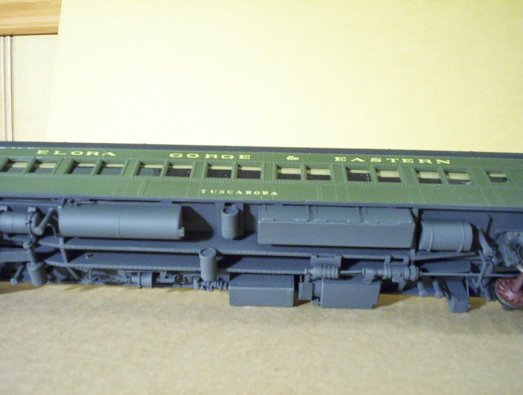

With a few details, plus some added weight, the Rivarossi cars, in my opinion, are perfectly acceptable:
Coach
Pullman:
Diner:
Pullman:
They’re also great fodder for kitbashing, like this ex-diner:
…ex-coach:
…or ex-combine:
