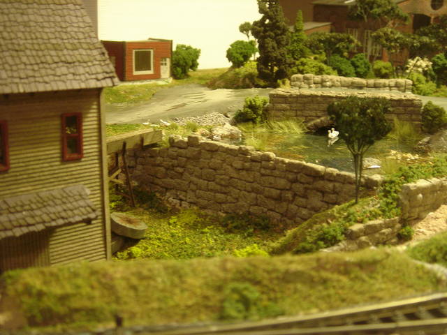

This is a construction photo of a short stone bridge I built.
I bought a Woodland Scenics plaster tunnel portal. It was way too thick, so I used it to make a latex rubber mold of the face, and then cast a much thinner piece with just the upper section of the portal. I used another stone wall casting as the inside face of the bridge sides. This is the way it came out, in the upper right of this picture.
