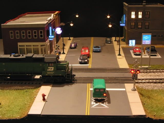

Here’s an example of the finished result.
Here’s an intersection on the layout.

I recommend the method ndbprr suggested - paint the stripe color first (yellow or white), then use 1/16th inch Chartpak tape to mark off the stripes. Use a straight edge to put the tape down. Paint the road and then peel off the tape. The nice thing with this method is that you don’t need to worry about the tape lifting off.
