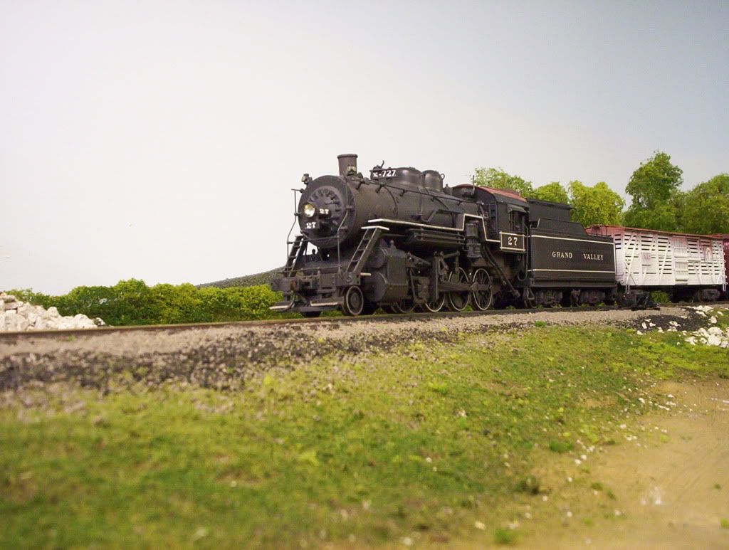

I used cork under much of my mainline, but not all of it. Here, the main tracks are on cork, with the sidings lower, directly on the plywood sub-roadbed:
Here, both mainlines and the sidings are placed directly on the plywood, with ballast and groundcover serving to differentiate the two:
Here, the mainline is again atop cork, but the trackside land (patching plaster on screen) drops away, easily done by placing the roadbed on risers, then contouring the ground as desired.
This can also be accomplished using foam scenery - a hot wire cutter allows you to shape ballast, roadbed, subroadbed and fill all in a single pass. There was an excellent article on this topic by Bill Darnaby, in the June 1994 issue of MR.
