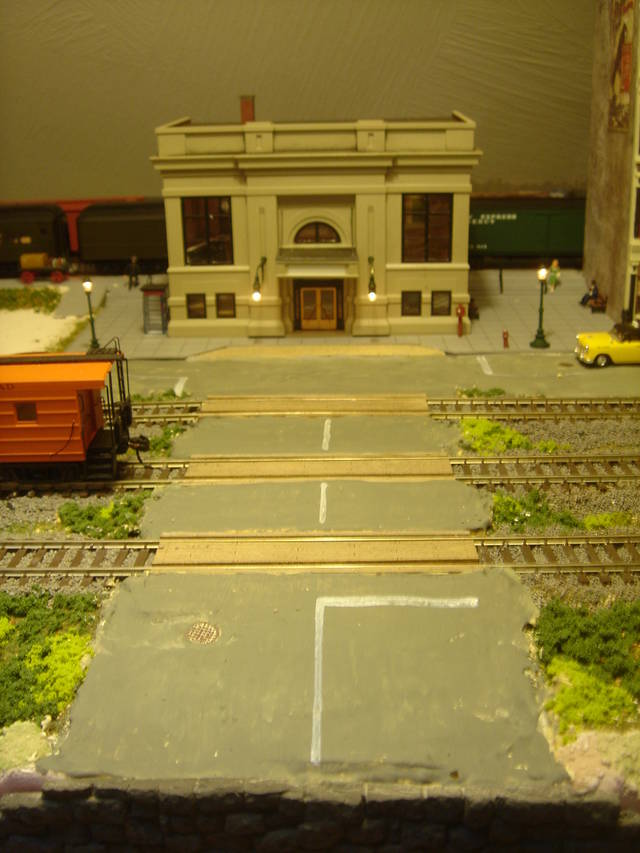

I’m also a fan of Durham’s Water Putty. It’s a hardware store item. It’s a powder that mixes with water. I add a bit of white vinegar to the mixture to slow down setting and give me a longer working time. It is naturally a light tan color. I use a foam brush, kept constantly wet, to continually smooth the surface while it sets, usually about a half hour. Once dry, I use a wash of gray craft paint, applied in several applications. This gives a color that’s not quite uniform, more realistic than a ‘perfect’ paint job.
I applied the white lines with a felt marker.
