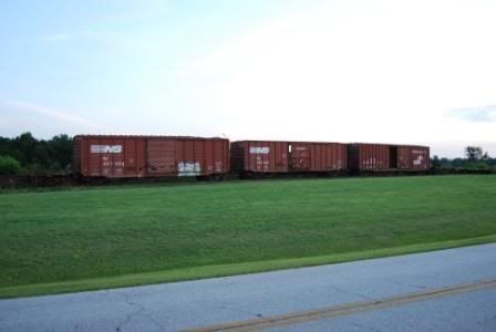

However, as far as the roof walks I think that is very much prototypical. I saw a couple of NS cars at the end of their 40 year life span that still had them a couple of years ago (I have pics of them as well). If they already had them I don’t think that their was any organized effort to remove them.

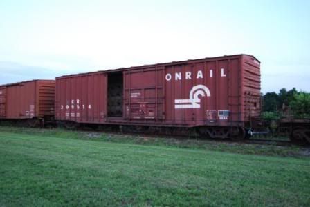

Note the Conrail one that I mentioned at the end of my first post. That was an example of a Conrail Boxcar that made it all 40 years (edit) with the raised brake wheel, but not running boards. (Conrail 209514 BLT 11-64). The picture was taken in 2004. I’m sorry that the pictures are no longer online, but if you will give me some time I will rescan them to show you.

Ok, I take back what I said about the running boards. I just went and looked at that old Conrail boxcar and snapped a few digital pics. I’ll upload them in a few. What I was remembering was the high placement of the brakewheel. The top of the car does have brackets for running boards, but the boards themselves were removed.

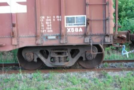

Here are the pics…sorry about the tiny size, but I didn’t want the people on dial-up to freak. You can’t really see the brackets that I am talking about, but you can see the high break wheel and that CRBS marks that you were talking about.
BLT 11-64 X58A
CBRS 4-86
I think that the Athearn model is probably off a little bit, but I really would like to know what that CBRS stands for…
Whatever!
If I remember correctly, the date after the CBRS is the reweigh date. The CBRS is probably the code for the shop that did it. If you want to know for sure, ask on the Trains forum.
