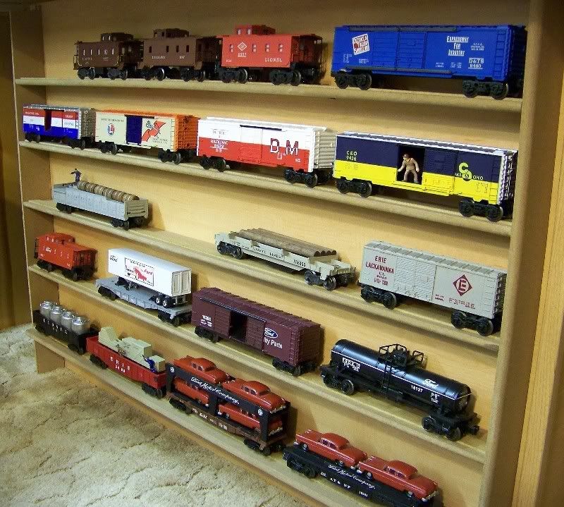

Did all mine with table saw and regular saw blade spaced 1 1/8 inches apart for the wheels.
I ran out of walls.

Looks great! Bet you saved a ton of $$ from what it would have cost to order. (Apologies to advertisers here who are marketing these)[:D]
Hello Laz:
That’s quite a collection. I really like those shelves!

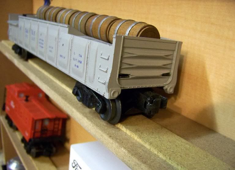

Here is shelving that I came up with that is inexpensive, nice looking and easy to do.
The shelves are made from 1/2" MDF and cut into 3" strips. Then 1/8" masonite hardboard is cut into 1" strips and glued to the center of the boards. I rounded off the front bottom edges, but this isn’t really neccessary. The shelves can be varnished, painted or left natural. The 3" MDF are flexible and must be supported every 18" or glued to a backboard. The wheels then straddle the 1" strips and keep the cars in place. I find that it is easier and faster to place the cars on this shelving than it is to try and fit the wheel flanges into grooves.

GIZ, Thanks for the kudos.
JACK, whatever blows my dress up that nite, I end up running. [;)] Like different stuff every so often. I figured why have sidings? I can cram more junk into those places.

JACK let me know if you want demensions of the shelves? Very easy to make.
laz57
Great pics guys, thanks for sharing your pics and ideas! Dave, very interesting idea on your homemade superstreets idea.
Thanks, Laz. The dimensions would be very helpful. I would have gone the “track on piece if wood” approach without this thread. For display purposes that may be preferable. But for functionality and ease/quickness of train transfer, the router approach would be better for me. While each of us has our favorites, this easy access would encourage me to use all of my trains.
