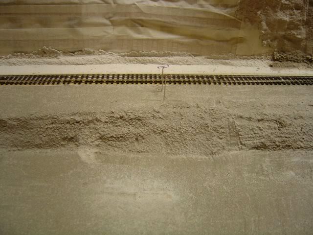

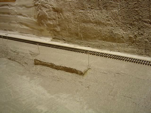

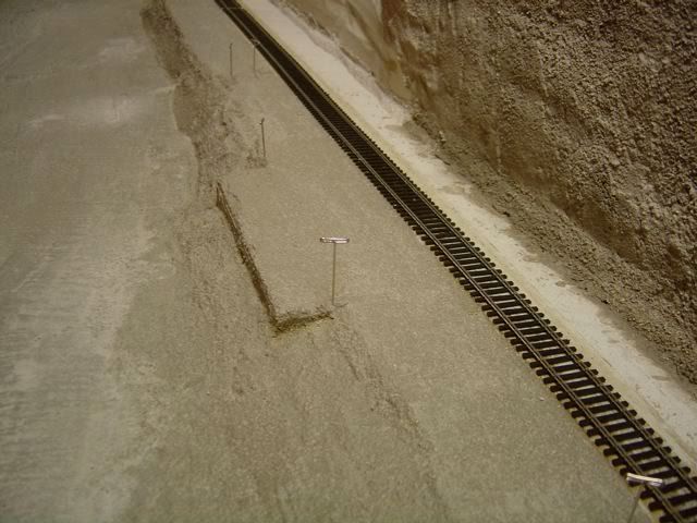

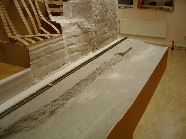

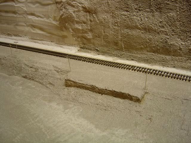

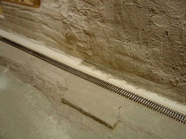

I have worked very hard with this scene and today, something strange happened. I looked at the model railroad and I was dreaming as usual. Wow, this feels like a real model railroad, for the first time since I started. A very great feeling. It’s amazing how much some vermiculite mix (vermiculite, plaster, cement, water) can do to the overall look of a scene. I think it’s the gray cement color that makes that happen. Here are some photos:

Kris, This is vermiculite mix that I learned from our friend at this forum, Joe Fugate. The mix: 4 parts of vermiculite, fine grade less then 1 mm in size is the best but I can never find that here in Sweden so I used 1-2 mm. 3 parts of plaster, I have tried different kind of plaster and right now I’m using plaster that are normally used for fixing walls. I don’t know what you guys call this plaster. 1 part of portland cement, you will get a very nice gray color with this, and the plaster will also harden quicker with cement. So use a plaster with a long setting time, like an hour. 4 parts of icecold water. If you use cold water you will get longer time to work. I mix everything except the water in a plastic container. Then I add the water and mix it good. protect your eyes because it’s not good to get plaster or cement powder in your eyes.
