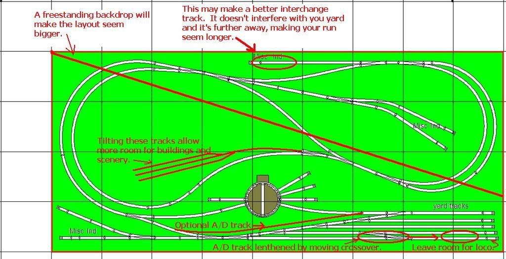

Garthor,
You have the basics of a good plan. I’d like to show you a couple of options that I see open to you that might improve things a bit.
http://i83.photobucket.com/albums/j319/pcarrell/Track%20Plans/Layoutn11-2.jpg
ok here it is revised again. Lets see here an idea was to put the interchange track coming in from the top left diagonal ? I also changed the siding on the lower left corner, to a single track.
http://i197.photobucket.com/albums/aa153/garthor1/Layoutn11-2a.jpg
Looks pretty good, though I think that you might be better served using those two lower tracks of the yard (at the lower right of the layout) as an A/D track like was suggested previously. Then you can have one train arriving on the A/D track parallel to the yard ladder, and another preparing to leave from the other A/D track (or vice versa, whichever works better in the overall flow of things).
Also, if I’m understanding your diagramming correctly, you’re going to have a very steep climb at the interchange track as you have it drawn. You have what looks to be less than 2 feet to climb 4 inches - thats something like a 16% grade. Not only will your trains not be able to climb it, the rise will just look wrong. Perhaps making the “misc industry” track at the upper center the interchange track would do you better. That is, unless you’re going to make some of your own special trackwork to fit a pair of crossings there.
Other than that, the trackplan looks pretty good to me.
Exactly!
Since this is N scale you only need 2" of clearence, but even if you start the grade right off the main you still only have 3.5’, which means about a 4.5% grade by the time ytou add in the transition. Thats still very steep.
That was precisely my thought.
