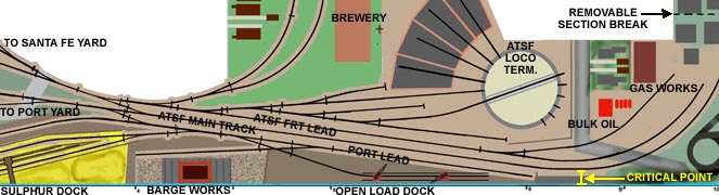

From nof: “Another unavoidable type of s-curves is crossover switches.”
Not necessarily. Notice the crossover from the ATSF mainline to the ATSF yard and yard lead. Track from the mainline curves to the right at the first switch, goes onto the STRAIGHT leg of the yard lead track. No S-curve. The trick is that it is not a crossover between two parallel tracks that continue straight and parallel on both sides of the crossover. That would require a curve one direction and then a reverse curve back. But here the crossover is placed to USE a short curve.
(Click on plan to make it legible…)
I wrote about this in Model Railroad Planning a couple years ago.
The layout plan as shown here DOES have an S-curve on the lower crossover, the one between the entry to the port terminal railroad yard and the switching branch at the bottom of the plan than accesses several dockside spurs. But I have revised this since starting the layout, curving the port yard entry to parallel the ATSF yard entry for a few inches. This eliminated THAT S-curve. The only S-curves left on the layout as it is being built are long broad stretches with several car lengths of straight tangent between the reverse curves, or track used only for very slow speed switching of a handful of short freight cars in a tight waterfront area.
