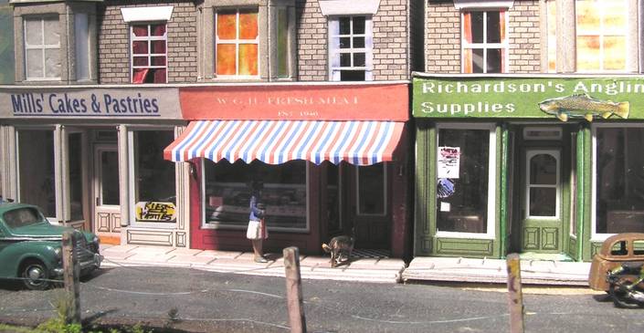

I scratch built several HO scale buildings on my layout using paper for the awnings. A pattern was printed using my HP inkjet printer, and I coated the paper with White Rain Extra Hold hair spray on both sides to stiffen it. The support frame was fabricated from music wire and strip styrene.

If you’re talking canvas awnings, mine were made with paper, printed with a pattern made up in MS Paint program. Supported by fine copper wire. It takes a little bit of trial and error to place the side supports at the right height to get a sag . Careful bending upwards of those side supports gives the sag.
Mike
