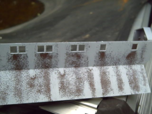

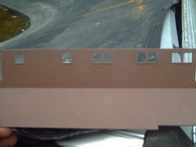

Start with painting your object with the colour you want too see after you paint the top coat
next mist with water and coat, sprinkle the desired amount of salt ,amounts will veri, practice makes perfect
hopefully thing will turn out similar to this, this is the first time and the will be some difference’s next time
now you can weather the normal way, i think

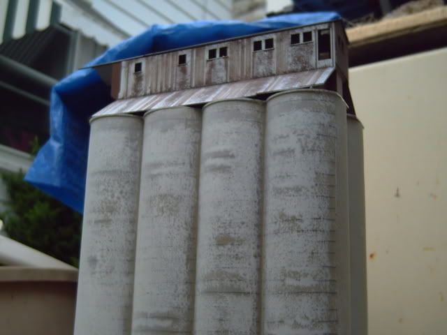

here is somemore of my new technique of weathering with table salt
Lookin good Rick. I saw that article and immediatly thought,“that’ll work on trains really well.” Hope to try it one of these next days. The article is actually in a special edition called “How to paint and weather scale models.” The article described the use of salt on a model of a japanese plane and on some armor models. The mag should be available in the grocery store newstands yet. A short version of the article is that you apply regular table salt to a model which has been moistened where you want the salt to stuck then sprinkle salt on the areas you don’t want the final coat to stick to. After the final coat you rub off the paint revealing the metalic undercoat. You did a good job on the grain elevator.

got to admit though , that’s a very effective weathering technique . your model looks great

your weathering looks great, very impressive.
