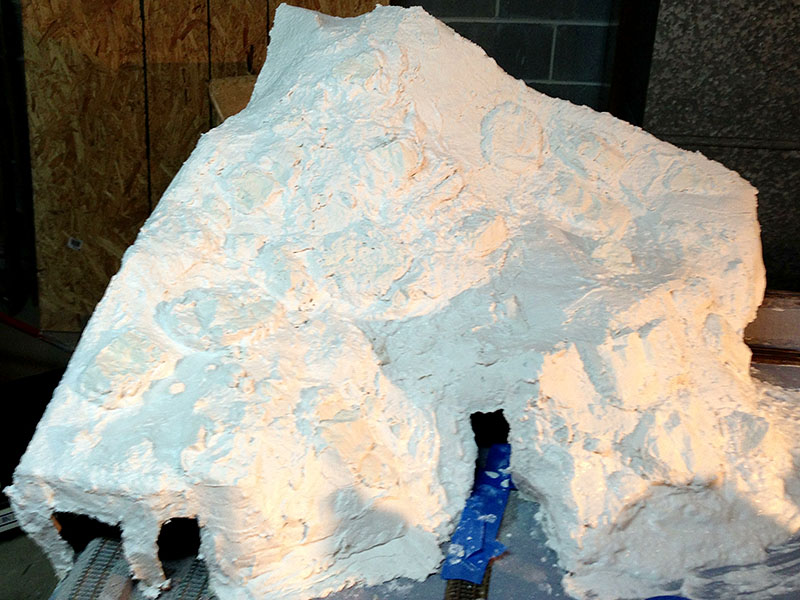

First, thanks to fellow forum member Brad (twcenterprises) for taking the time and trouble to come over to my mother’s house to help me build the cardboard skeleton of the mountain on my son’s layout. I appreciate Brad’s help and will never forget it.
Brad and I put the first layer of plaster cloth on after we finished getting the cardboard strips together, and the next day I put a second layer of plaster cloth over the first. (I didn’t have enough plaster cloth to put on two layers at once.)

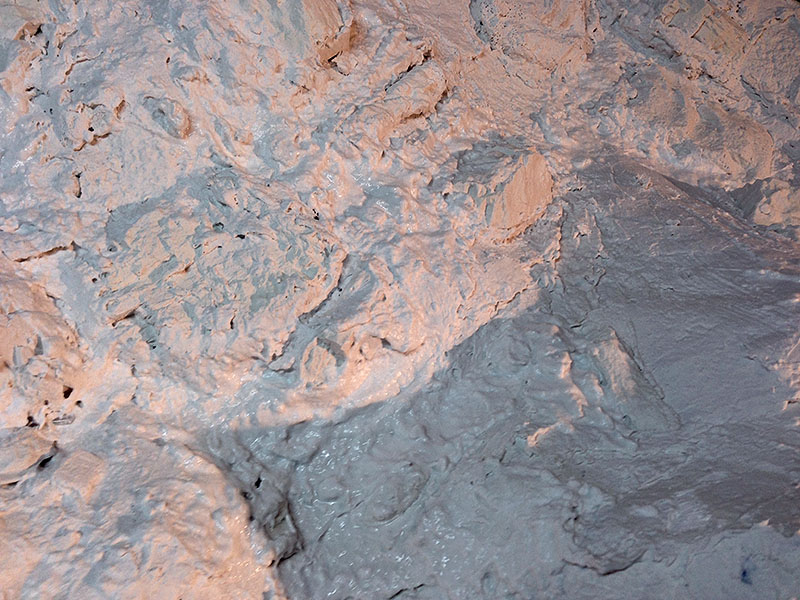

And a day or two after putting on the second layer of plaster cloth my wife and I slathered on a really thick layer of Sculptamold. We put on more than a dozen Hydrocal-based rocks but due to the texture of the Sculptamold we can hardly see the rocks.
My best guess is that I should stick to the plan of painting the non-rock areas an earth color and painting the rocks to look like rocks. Then I’d put clump foliage, lichen, and ground foam over parts of the mountain.
But what do you think I should do?
If I had it to do over again, I would opt for wood and screen wire for the skeleton of the mountain because the cardboard strips gave in to the weight as we were putting on the Sculptamold. We stuck a dowel under the mountain and that seemed to prop things up well enough for the Sculptamold to dry. The mountain was rigid when we started applying the Sculptamold, but soon the plaster cloth got wet and the whole structure became wobbly and unwieldy. Having a sturdier skeleton would have been a help in our situation.
I don’t have a single straight pillar to stick any portals on to, so what I

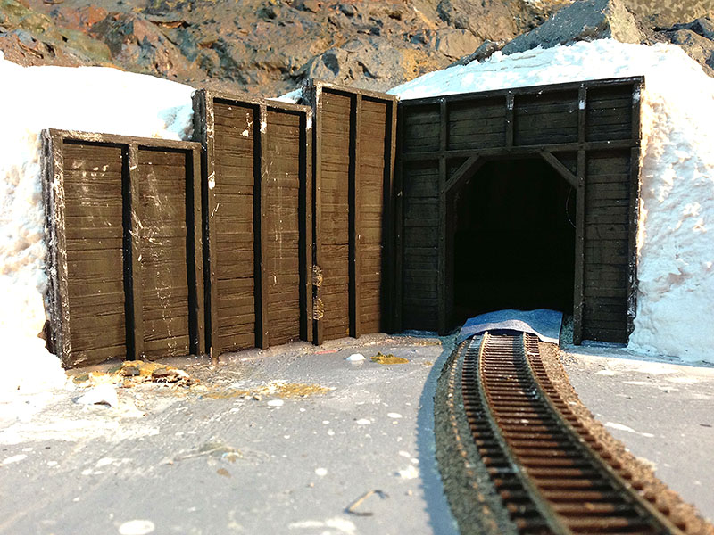

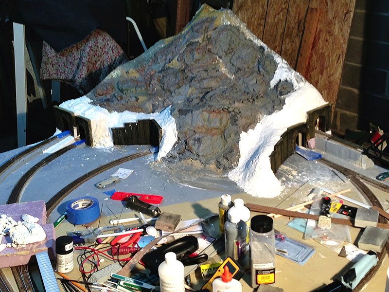

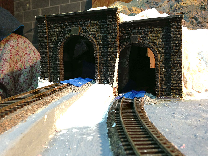

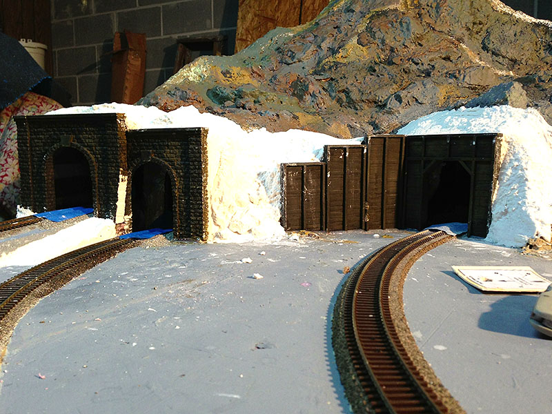

Here are a video from about a week ago and six pictures from today:
http://youtu.be/k7xZxN7lgMY
I loved CTValleyRR’s advice about using a black wash on the portals. Maybe I can get some advice about how to paint the rocks given how I already have them painted. They need highlights, more grays, some green, and deeper shadows. I bought an airbrush (Paasche VL200), but I haven’t gone through any of the practice lessons with it yet.
