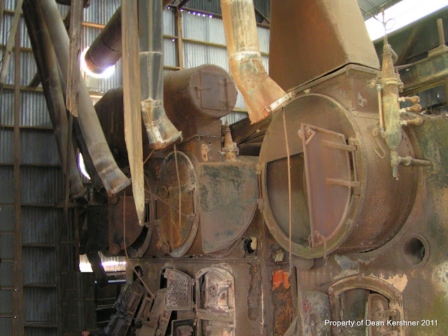

The mill in Longleaf LA used tubes to transport the sawdust to the feed boilers in the planer mill and powerplant, it just wasn’t wasted. I’m unsure if it was a vaccum or pushed.
Here is whats left standing, under the water tank. Sawmill is to the left and planer mill to the right.
