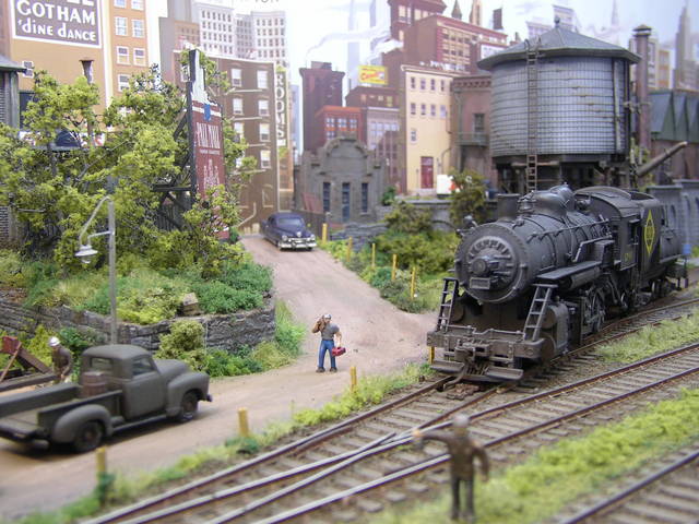

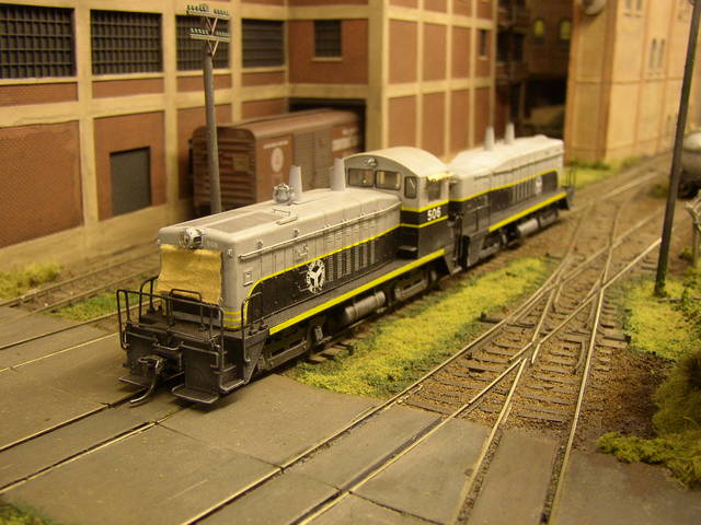

I’m very pleased with my #148’s, as they fit spaces that only McHenry’s would fit before.
Whisker-fitted Bachmann Spectrun 2-8-0
Whisker-fitted BLI SW7 (now a TR4)
I’ve not had the opportunity to try out the scale version yet, but I’m sure they will work equally well.
