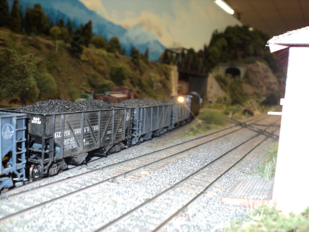

Things turned out really well! I’m happy with the results. I have since placed the loads in the cars and they look great!
Thanks to all for the helpful suggestions and ideas.
