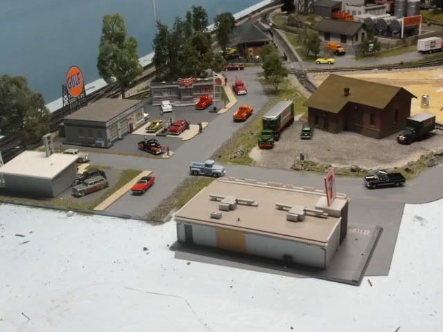

Here’s a gravel road and parking lot on my layout:
I brushed 50:50 diluted white glue over the area and sifted fine sand over it. It took two applications of glue and sand. Once everything was dry, I dry-brushed a matching color of acrylic craft paint to represent tire tracks, compacted/dried mud and so on.
No additional smoothing was needed, as sifting the material onto the glue yielded a thin layer that was automatically smooth enough to work. Not that the sand I used was finer than most ballast, but following the same process with ballast (for larger gravel) should produce an acceptable smooth surface.

Your road and parking area look great Rob! Looks like the effect I’m looking for definitely…
