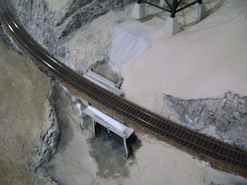

Here’s the same scene before and after ground cover added per the above.
This scene has a combination of thinner ground cover attached purely with the brush coats of glue, and other things (like the rocks in the bottom of the dry wash, talus, the railroad embankment, ballast) which were applied dry and glued later. Other items like the larger bushes were added with full strength glue after the basic ground cover was complete.
