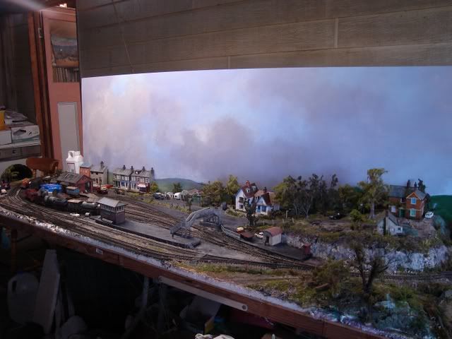

It was 24ins high on my old British layout - 00 scale, not much bigger than H0. That gave me plenty of height for photos looking across to it, but photos taken lengthwise often had to be cropped because the top edge of the board angled down into them with perspective, so as far as I’m concerned, the answer is to make it as high as you possibly can, to cater for all viewing angles.
Mike

I think you will have to look at your own layout and make a decision based on cost, location, what is or is not going to be on the layout as it progresses toward completion.
In my case I just ripped 4’ x 8’ sheets of hardboard lengthwise and mounted them using 10/32 "T"nuts and bolts. It can come off in a flash using the drill. My artistic abilities leave much to be desired as far as clouds go. When I’m finished a very talented friend will come and clean up my shortcomings in the cloud/backdrop department.
As far as how high to make your clouds and citiscapes? Just see how it looks. Remember also that things look a lot different in photo’s than they do in person. Just something to think about.
Brent[C):-)]
