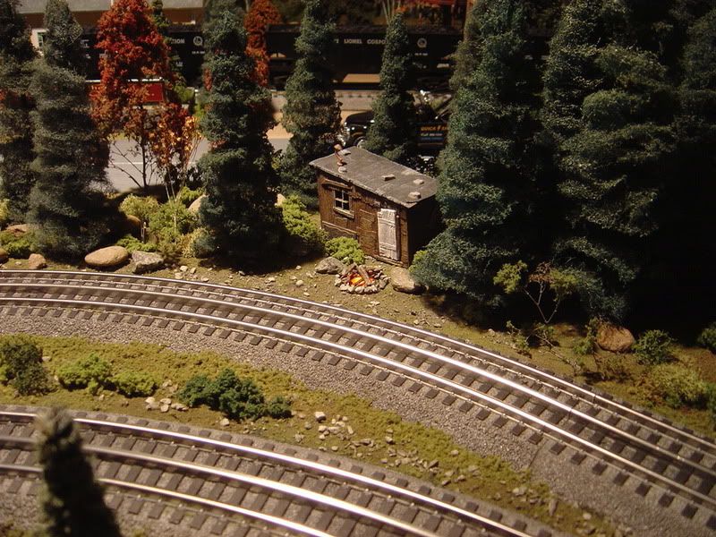

I started by painting my board a dark brown. Once dry, I sprayed down a glue and water mixture and applied a combination of Woodland Scenics fine and course ground foam in colors such as “Earth”, “Burnt Grass”, and “Grass”. Fine ground foam by itself looks too smooth, like manicured lawns, so I used a lot more course foam in areas like these. The added texture makes the scene more interesting and believable.
The bushes are made from inexpensive Reindeer moss, available at craft stores, and clump foam, in light and dark greens. I glued the bushes down with 100% white glue.
The very small light gray rocks are just landscaper’s stone dust, like that used under a brick walkway. The larger rocks and the sticks are from our back yard.
The green trees are homemade from furnace filter material, ground foam, and meat scewers.
The FasTrack was treated with a wash of black craft paint to bring out the molded in detail of the roadbed.

Thanks, John. That’s very kind of you. But honestly, all my technique consists of is spreading a puddle of glue thinned with water and sprinkling different types of ground foam into it. Then we dropped the stone dust rocks down and let them land where they may. The area stays wet for about 24 hours, so you would have plenty of time to experiment.
I really think the key to nice scenery is getting plenty of texture in there. Whether it be rock or flora, the more texture the eye sees, the more natural or realistic it percieves it to be. You want to have a lot for the viewer to look at. Stones, large rocks, bushes, thick grasses, leaves, etc.

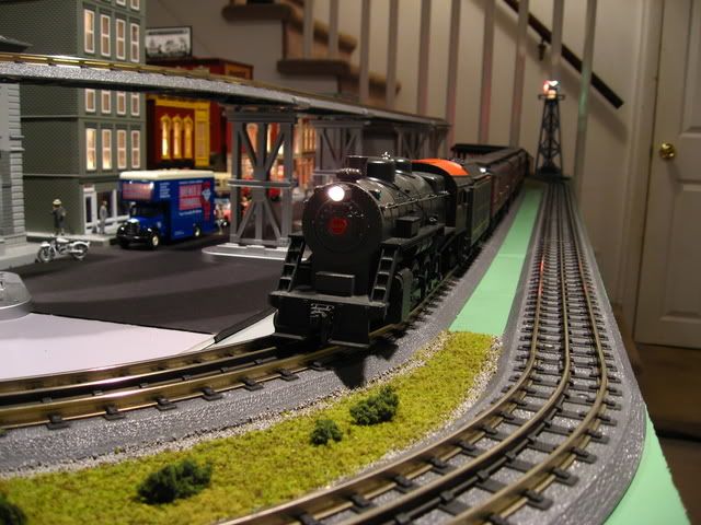

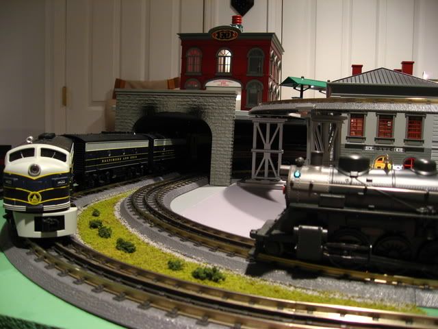

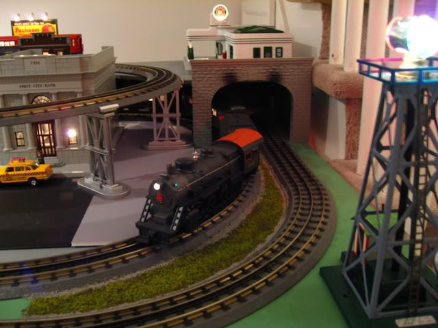

Hi Guys and Jim,
Since I asked for your help with my little “between the tracks” scenic-ing endeavor, I thought it only right to show you the results so far. I did as you said, with the added step of drizzling some grey ballast at the edges of the RealTrax for a little more “realism” and I’m pretty happy with the way it looks so far. I still have a 3 ft length to do, as well as adding some additional different colored bushes, and maybe some weeds coming out amongst the ballast, and small pebbles, but here’s what I have so far. You can see in the last photo the improvement over the undone strip in the middle. I didn’t go with the first step of painting the base a brown earth color, because It was already green, and I hate to have hardly used opened cans of paint piling up in the basement, but for someone starting from scratch, I would recommend painting the base brown first. This way, you can go really easy with the ground cover, and not have to worry about laying it on really heavy, because whatever tiny areas of paint show through would just look like soil, and maybe look more natural. Again, thanks, Jim, for your help! And congratulations on your spread in CTT!
Beautiful job!
Wow! What a difference! You’re on your way too! It looks great Newbielady! Keep posting progress photos.
Jim
Hello Newbie Lady:
Very nicely done! Isn’t amazing how a little landscaping adds to the layout? Keep us posted on your progress. While I am in the midst of doing some of this myself I am quite envious of your results.

Thanks Guys!
I really think if I were to start again, the number one thing I’d do is paint the base brown. As you can see from Jim’s scene in my first post, his seems to be done with a lighter hand, with a bit of earth-colored base showing through (at least this is how it appears to me). My ground foam is a bit on the heavy side, because I needed to totally cover the weird green paint. As a result, it’s a little too manicured-looking for a neglected area between the tracks, but I agree, it gives it a lot more “atmosphere” than just paint. I’ll post the final product when it’s totally finished!
