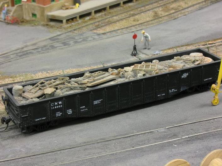

These are my scrap loads, removeable.
Wolfgang
I think you are on to something, Wolfgang. Very realistic, and nicely executed. [:)]

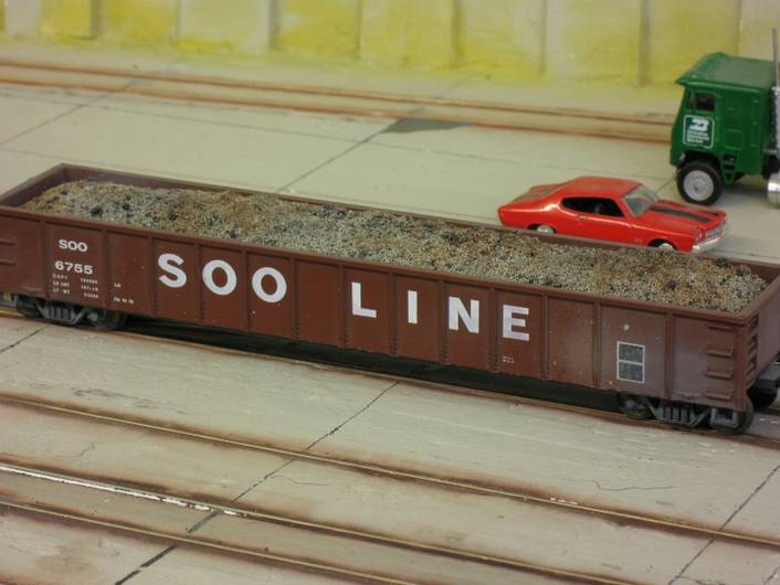

Spray aluminum foil with several colors of spray paint. Put the foil and water to cover in and OLD (heavy on the old) blender. Blend until chopped up. Strain the foil shreds. Let dry. Glut to foam or balsa pieces that fit in the cars. Give a slight overspray of rust colored paint. Soak steel wool in vineger. Dribble the fluid (NO solids) over the scrap piles. Let dry.

You read my mind, that is exactly the idea I had! Now I just need to find a cheap blender, off to the pawn shop![:D] Maybe I can find some old alarm clocks to tear apart while I’m there. Thanks for all the tips and also the great photos!
