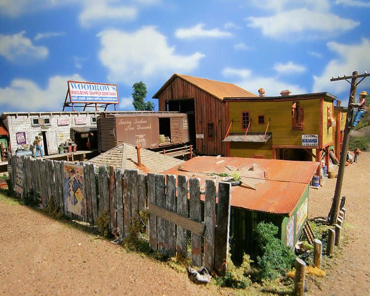

I’ve posted photos in a Flickr web album showing steps I took in scratchbuilding a copy of the Fine Scale Miniatures “Baxters’ Building Supplies”:
http://www.flickr.com/photos/railwayphotog/sets/72157600826399421/
Not captioned, but just illustrating how I did this diorama with multiple structures:
