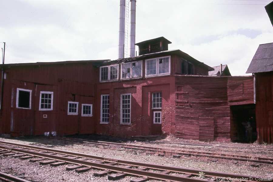

Here is a model of the steam plant at the East Broad Top RR:
Here is the original. I haven’t done the roof vent yet:
