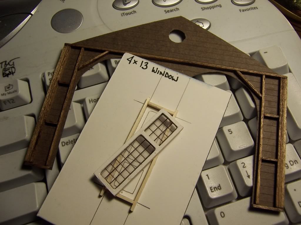

After starting one of the side walls with 4 big windows, I realized I had never made windows and had to figure it out quick ! Decided to create the windows using an Excel spread sheet and printing it out onto overhead foil material … came out pretty good.

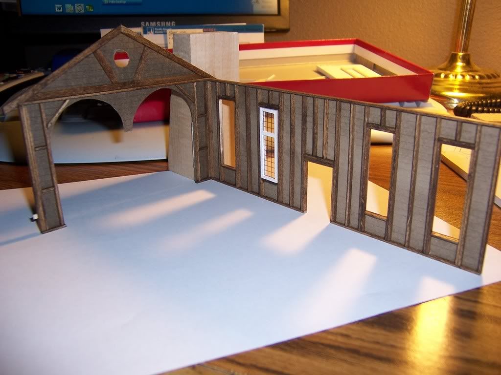

Have 2 walls that are done enough to at least lean against each other to get an idea of sizing, etc.

Window - pre-assembly
Window - post-assembly
Front & side walls in varying states of completion

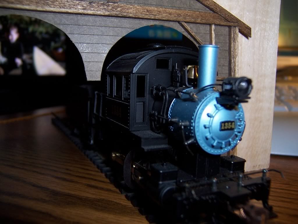

With a loco for scale
really nice work on the model , but i have to ask … it looks like the loco is too big to fit through the doorway of the engine house . is it ? or is it just an optical delusion ? [:)]

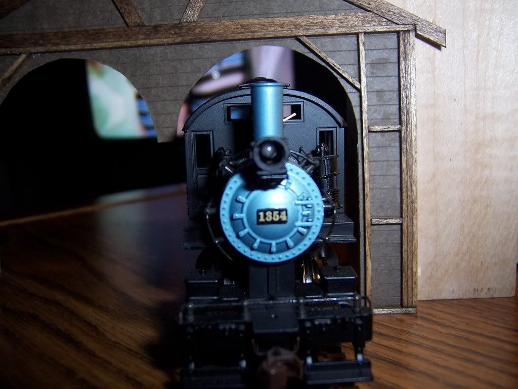

Valid question about clearance … fortunately, there is about 3 scale feet all around as shown :

ok it was just the angle the photo was taken at . i should have known that you’d thought about clearances before you started construction !
