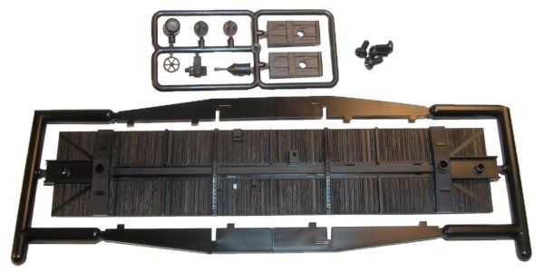

Here’s a link to Accurail’s fishbelly underframe which can be purchased separately.
As for the steam (and signal and air) lines, Cal-Scale’s Part #275 will get you them in plastic, or if you prefer brass, it’s Part #274.
Thank you. I reached out to Accurail to order their frame separately, if for no other reason than to copy it.
