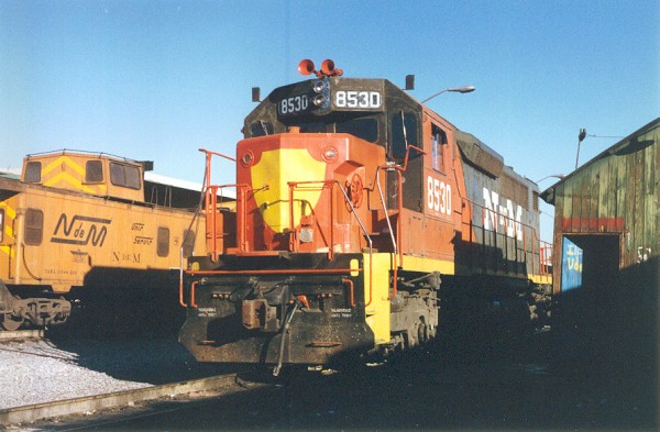

Great Northern’s six SDP40s were built with ratchet handbrakes. From the photos I can find, the 14 built for N de M all seem to have left the factory with a larger notch for a brakewheel like this (which matches the current configuration of the KCS SD22ECO rebuilds):
This appears to be the same arrangment as other contemporary units like the SP’s SDP45s.
Here’s TFM 1319, ex N de M 8531, the unit that eventually became KCS 2600 (shown here as an SDP40 prior to rebuilding). I couldn’t find any photos of the 8531 in original paint, but I’m reasonably certain it wasn’t built with a ratchet handbrake like the GN units.
