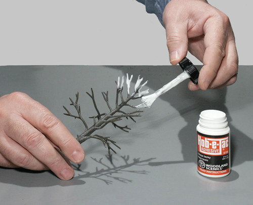

There’s a product called Hob-E-Tac that looks just like white glue but dries “sticky”:
Apply the Hob-E-Tac to the armature tips BUT…let it dry completely BEFORE adding your green foam. (If the Hob-E-Tac is still wet, the foam will NOT stay on the armature.) The Hob-E-Tac will definitely feel sticky when it’s dry. Cost: $5/bottle.
