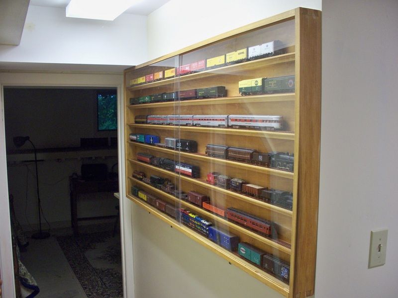

Not an uncommon problem. I made this display case/storage locker pretty much from scratch.
