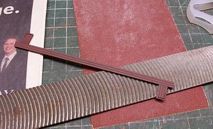

I’m not sure if there’s enough room in that locomotive for it to work, but another option might be an autobody file…
Autobody file with typical roofwalk...
I use them all the time for thinning stock plastic running boards, and they remove the material quite rapidly. I tried one, a minute ago, on a cast zinc steam locomotive frame, and it removes that material pretty rapidly, too, although not as quickly as it does plastic.

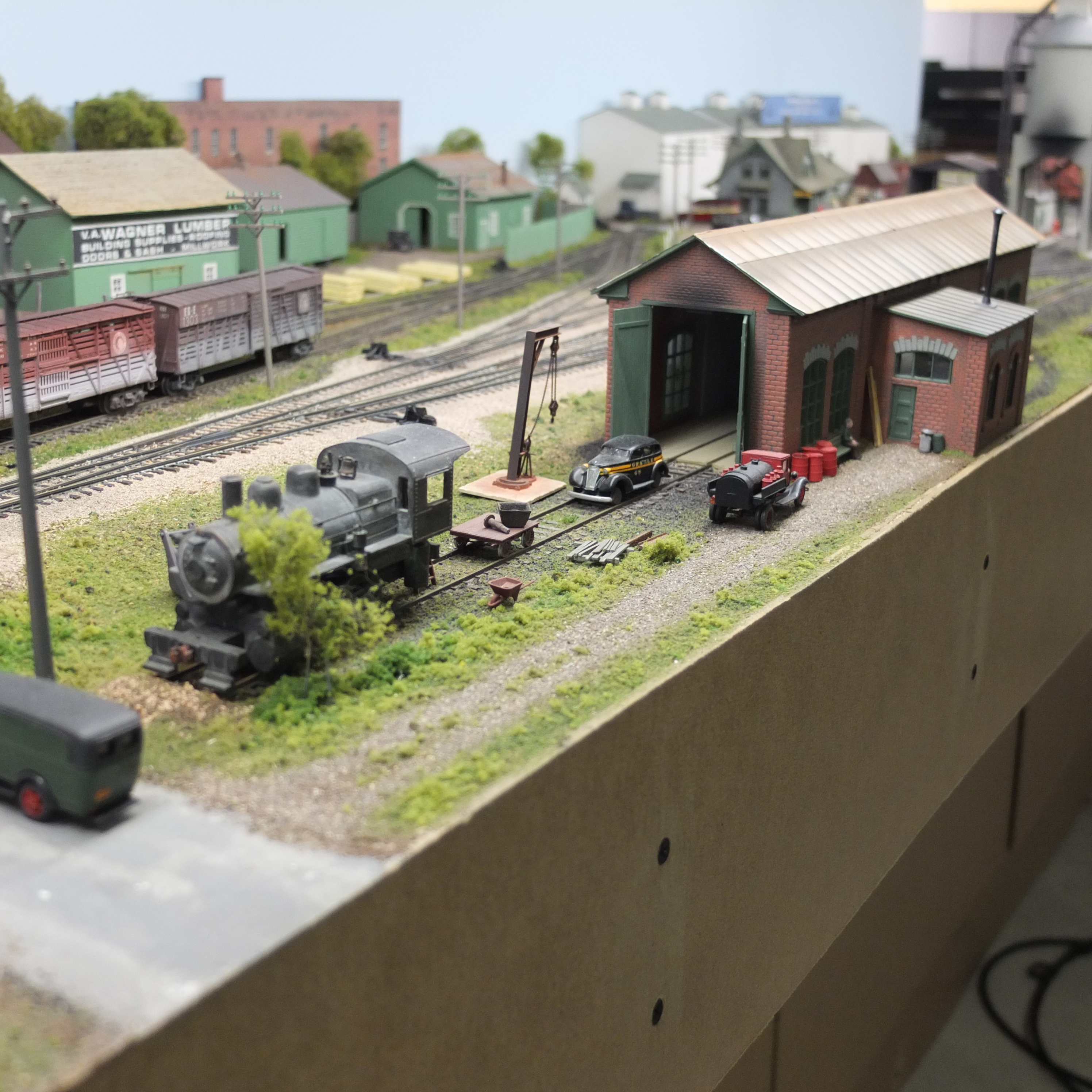

I also checked my John English “Yardbird”, to see the location of the material you need to remove. Mine’s retired - it never was a good runner, but it makes an interesting scenic feature as it awaits scrapping…
LAYOUT VIEW AT LOWBANKS CAR SHOP...
