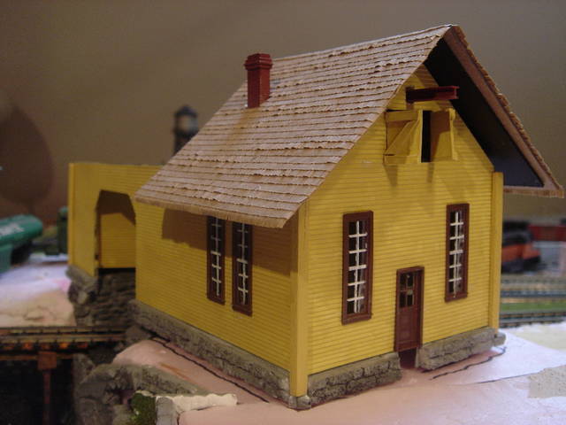

I can’t say which is my favorite, because I’ve only used Campbells. Even then, I’ve only done a couple of structures. Still, I’m pretty happy with them, and I’d buy more. One package lasts a while. It comes with cardboard roof pieces, pre-marked with lines for the shingle strips. The strips come on a roll, and you just cut them to length. Moisten the back with a brush, and stick them on. The glue is like old postage stamps.
This structure was made with Evergreen siding and Tichy doors and windows. The foundation is a thin strip cut from a much larger rock wall casting.
