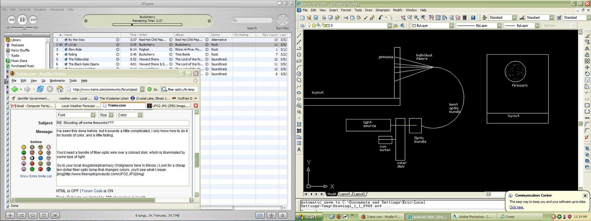

I’ve seen this done before, but it sounds a little complicated, I only know how to do it for bursts of color, and a little fading.
You’d need a bundle of fiber-optic wire over a colored disk, which is illuminated by some type of light. Put pinholes in you backdrop, and stick the fibers through them.
Drawing:
(sorry for the poor quality, I just captured a screen off my desktop.)
http://img.photobucket.com/albums/v729/Th1nkg33k/PSD/desktop.jpg
Go to your local drugstore/pharmacy (Walgreens here in Illinois.) Look for a cheap ten-dollar fiber-optic lamp that changes colors, you’ll see what I mean.
[img]http://www.fiberopticproducts.com/UFO2.JPG[/img[
