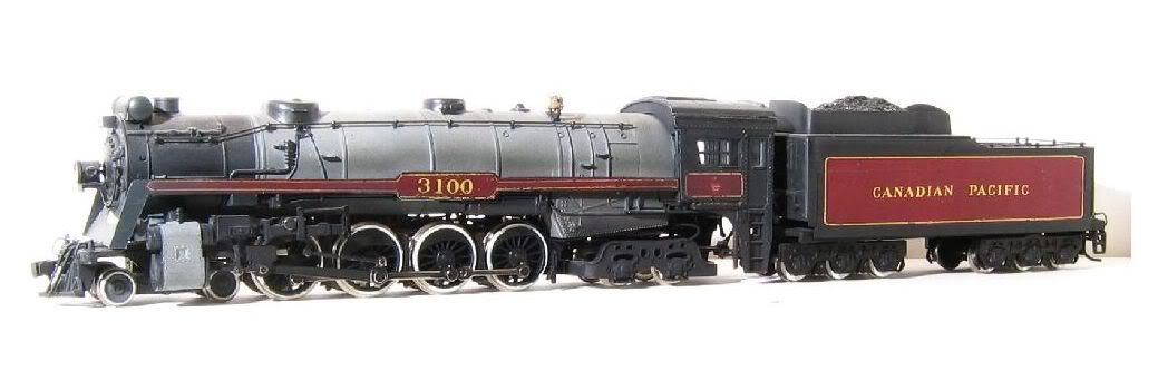

A few years ago I did a kitbash of an IHC/Mehano 4-8-2. It has the same basic frame and overall dimensions as the IHC/Mehano 2-10-2. I added a small extension to the boiler and moved my cab back a little, but it might work for you as well.
I used a 4 wheel trailing truck from a Bachmann 4-8-4. It has a short 5’ wheel base and has the added benefit of 4 wheel pickup. At the time I just called Bachmann and ordered one.
