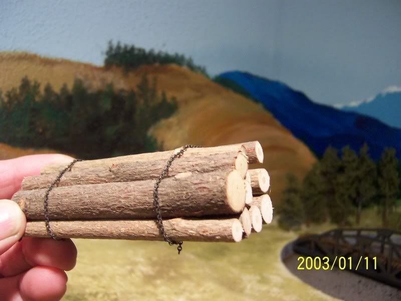

Not unusual but I came up with this method of log loads myself. I think. 45 years of reading MRs has fogged the memory. The logs are filbert suckers. The chain is from Model Shipways. The logs are hot glued together and the simply ride on the bunks under them. Prototypical speeds prevent flyoffs.[IMG]http://i56.photobucket
second pic. I couldn’t get both to post for some reason.
