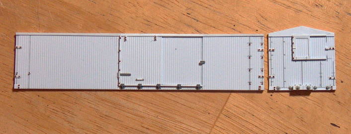

I tested something interesting today. I took some white glue on a needle. I used the needle to make a very small rivet on a piece of styrene. I repeated the process and got some very nice rivets. I know that this is not a new method but it works.
I’m looking for people on this list that have tried this and have some close up pictures to show. Please post a picture and describe your method.
