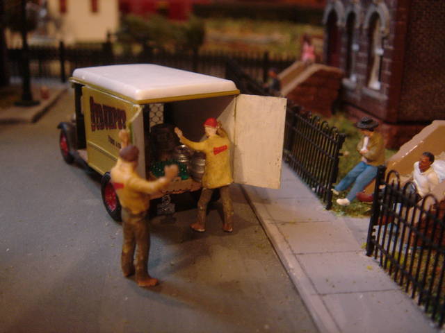

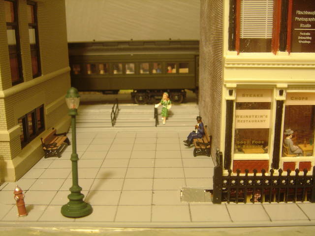

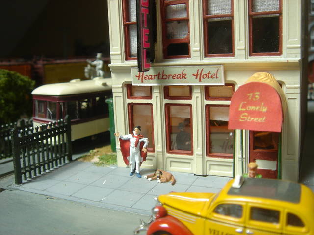

I use plain white styrene, cut to size. I paint it gray, and add the lines with a #2 pencil.
The first two were painted with acrylic craft paint. The last scene was done with gray spray primer. The primer is more durable, and takes the pencil lines better. I use a lighter shade of gray for the sidewalks than for the roads, which provides a good contrast.
I try to make my sidewalks very “busy.” Figures, fences, street lights, signs and hydrants all add to the scene and take the eye off the rather plain sidewalks themselves.
