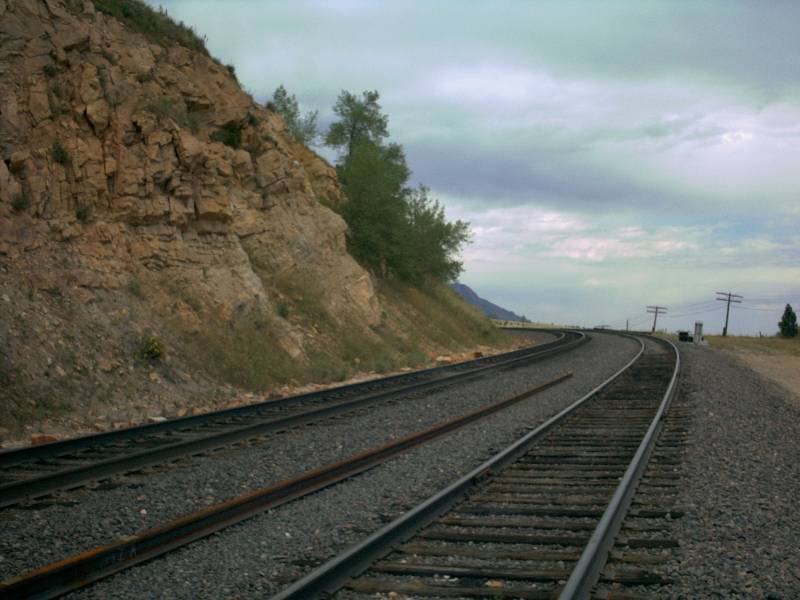

I’m building a siding on my D&RGW upper level, just want to check if a siding on a grade is prototypically correct.
Look at this picture of the siding at Clay, it seems that this siding have a pretty steep grade.
What do you guys thing, is it common to have a siding at a grade? My grade is around 2.4%

Most railroads aren’t flat. It is common for sidings and even yards to be built on a grade.

Although this would have been uncommon on the NYC, it wouldn’t have been for the lines out west. I have a DVD of the Durango & Silverton that shows a passing siding on a fairly steep grade.

It feels nice to know that it’s prototypically correct. Thanks guys for very good answer as always. I appreciate your help a lot.
