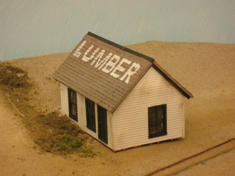

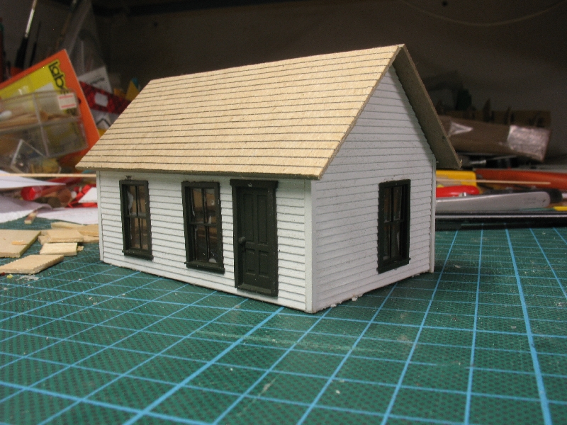

Well, I did it a simple way.
Here’s the scratch built office:
At first I printed the word in a suitable size and taped it to the roof. Painting the letters with a brush.
And the finished lettering.
Now I have to add more details.
