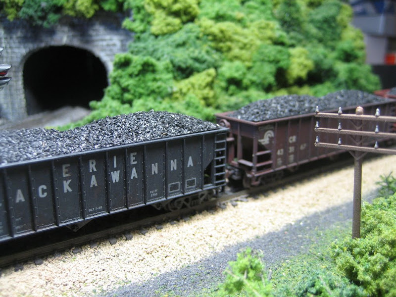

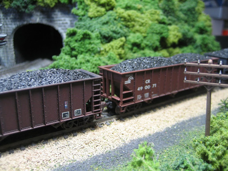

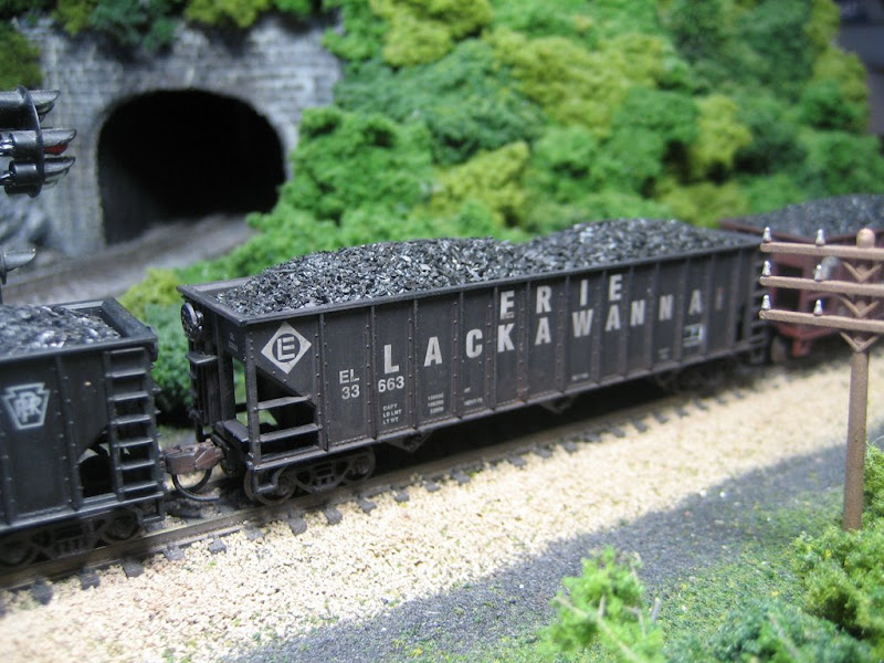

I use that blue insulation board that I cut to rectangular size on my tablesaw, cut the slope sheet angles on my bandsaw, shape a little, paint black on top, and spread scale coal into fresh black paint. Although out of focus, the following two pictures should give you an idea of the finished product. Note that I model a more modern era, so the coal would be a little finer and dumped into the cars with a flood loader.
