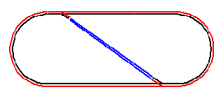

  • It this a DCC layout?
  • Does it look like this?
If yes and yes, does your longest train fit in the blue zone, because that is where you would attach your AR1

OP said he is doing this with 2 #6 turnouts, thus it will be a reversing section in one direction only. One AR-1 should do the trick. Having said that OP would be wise to look at Ed’s drawing and consider giving himself the flexability of reversing in both directions.
