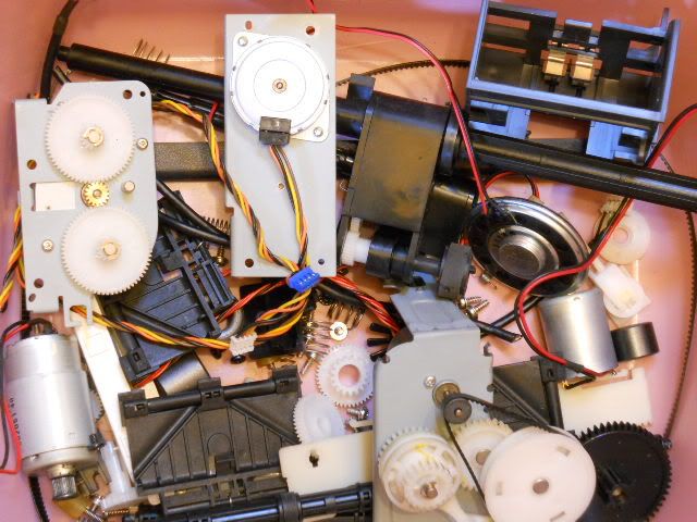

I just took apart our old Fax and copy machine and got 5 small DC motors out of it. Also there are all kinds of plastic gears tha would make great gondola loads. Also a few years ago I took a printer apart and found a small solonoid that was used to push paper. I used that solonoid to build my Gravel Loader that loads beach sand into Tyco operating hoppers. http://lariverrailroads.com/gravel_loader.html

This is the most recent take apart project. There are 5 motors, least one should be good for something.
