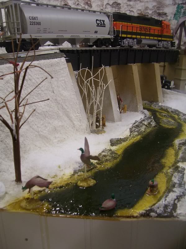

If you want permanent snow, here’s my technique. I paint the scene with any gloss white latex paint on hand, then while the paint is wet, I sift on FloraCraft (also sold as Buffalo Snow) Winter Snow (granules, not the coconut stuff). then I get some crystal glitter and wisp it over the landscape.
My winter themed layout has been up for quite some time, and this method is durable and doesn’t yellow.

Robert, great picture and great layout. I enjoyed your site. Those Black Angus cattle were ready to go! I need to get some new cattle for mine. The little rubber legs that let them move have been broken off the bottom of most of my cattle. I don’t know why. They are only 58 years old!
Thanks, Mike

Thought I’d throw you some old images to “sell” my technique.
