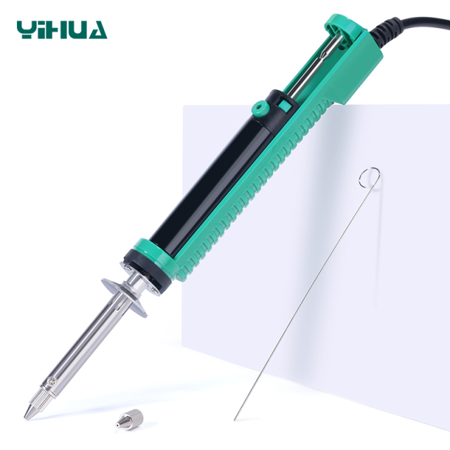

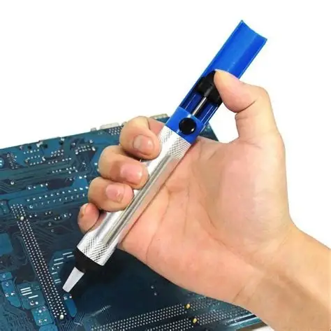

Excess Solder can be removed with a hot Iron and a ‘Solder Sucker’, basic or electric.
Both of these items are available from local stores or Amazon etc.
Wire can be removed using a hot iron and Solder-sucker. I use Heatsinks wherever possible.

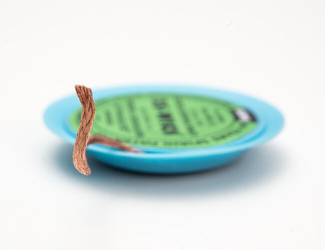

Desoldering wick.
Use any old soldering iron you want (above 35 W. at least). The wick is impregnated with flux so it draws the solder away from the joint.

I have used desoldering wick myself, and it works great.
I’ll try that also–I have some on hand.
The advantage of braid (either fluxed or dry) is that it can be laid adjacent to the joint so it can act nearly immediately when the solder liquefies. So however you apply heat to the top of the rail over the joint, a minimum of that heat will transfer to where the ties are.

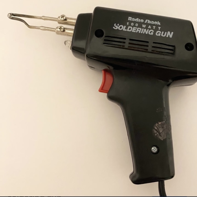

I have several different types of soldering irons, but the one that I use to desolder track is an old 100 watt Radio Shack soldering gun like the one pictured below.
You can buy a used one on eBay fairly inexpensively.
What I like about the soldering gun, as opposed to a soldering iron, is that the heating surface is a broad, rounded end that heats up immediately and very quickly softens the solder, permitting the soldered tracks to be separated quickly without melting the plastic ties.
A little more advanced than mine:
I do like the shape of the heated end of the Radio Shack soldering gun.
I can see that–the original tip on mine was more like it, but the new tip you see in the picture was made from a copper washer. No, I’m not joking. I ought to get a new tip for the thing. The washer tip broke after I dropped the darn soldering gun.

The reason thatI prefer my 100 watt soldering gun is that it heats up immediately upon pressing the trigger, and the wide heating surface very quickly liquifies the solder.
