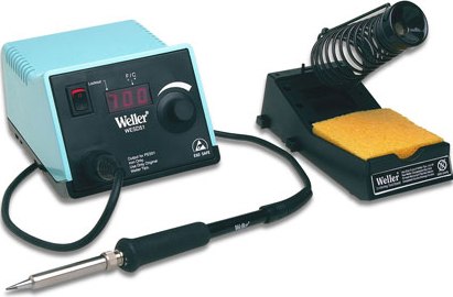

CBB,
I personally like Weller because they make a very good product and their tips are interchangeable/replaceable. I also prefer soldering stations (vs. soldering irons) where you can adjust the temperature of the tip; depending on the job you are doing - e.g. soldering track or soldering a decoder. Most adjustable models will give you a 350-850F (176-454C) working temperature range. Here’s the one that I own:
Whatever manufacturer/soldering station you go with, be sure that it’s a least a 50W model. Unless you are soldering thick sections of rail, 50W should give you ample power to solder what you need.

I am actually working in a college with teachers in electricity and electronics. Teachers and technicians all swear by Weller. In fact, the soldering station shown by Tom (stage) is the most widely used for electronics and wire soldering.
The one Tom has IS a very good one. Not cheap though. The Xytronics one I have is basically a knockoff.
