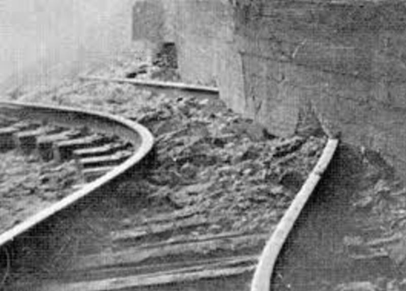

I had a large temperature swing in my garage when we first moved to Bakersfield (1987) and that’s where I built my layout. We had never lived in a location that had large differences in temperature so like all my other layouts over the years I soldered all the joiners. That was a bad mistake. On the second year I lost 11 sections of flex track do to the large temperature swing.
Looked a lot like this. (Bakersfield Earthquake 1952)
The track was Atlas code 100 Flex and one or both rails broke loose from the tie spikes.
The track couldn’t take the 70°+ temperature swing (35° to 110° in the garage) from winter to summer. We had the garage insolated (R40) and no more problems but then I didn’t solder all the joiners when I replaced the track either. I should have known better and left room for expansion.

In my disaster the track was Atlas code 100 and the ties were loosely anchored with track nails about every 12 inches in a hidden 30” radius helix (about 33’ of track) and the flex ties placement on the cork looked normal. The rails broke the spike heads off the ties.
The rails were well away from their correct position on the ties, the outside rails were pushed out to the edge of the ties.
I was so upset that I didn’t even think about taking pictures.
It was rather interesting in that only the hidden track was not ballasted and all the none hidden track was Atlas code 83 well anchored with ballast (about 90’). Only the unballasted track was effected.
I was the new guy on the block back then in a new city and bought all of my track from the same LHS. When I went in and bought the replacement track and told the owner what happened he said “bet you soldered the joiners”.
