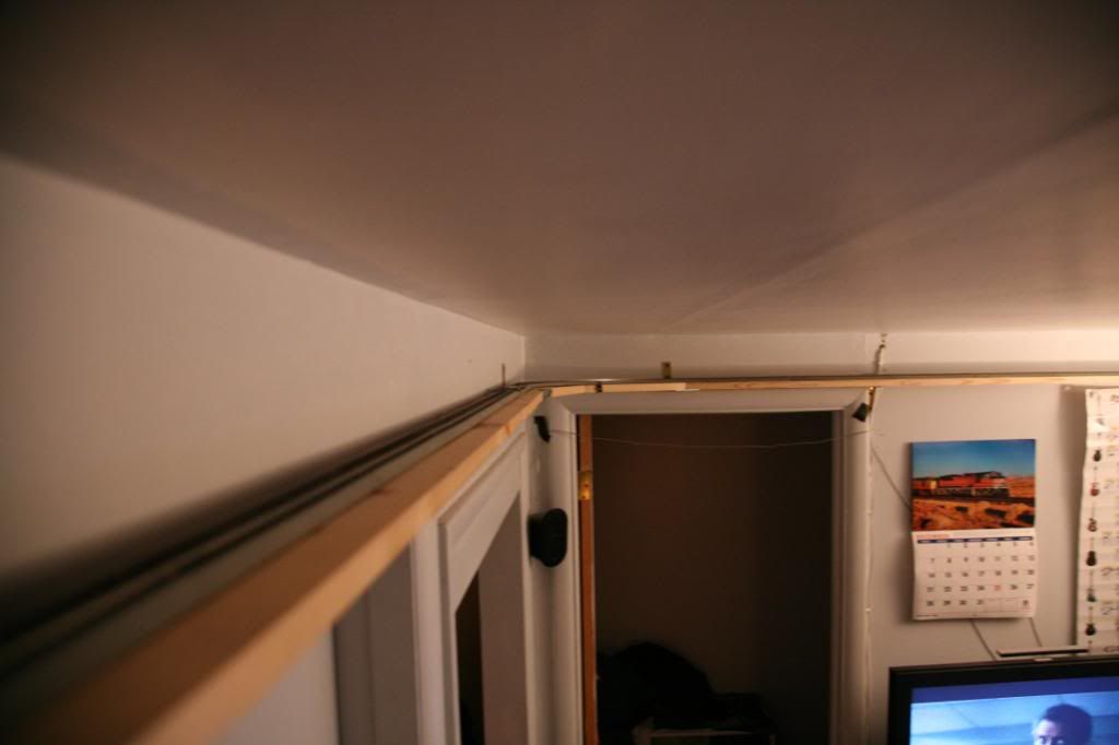

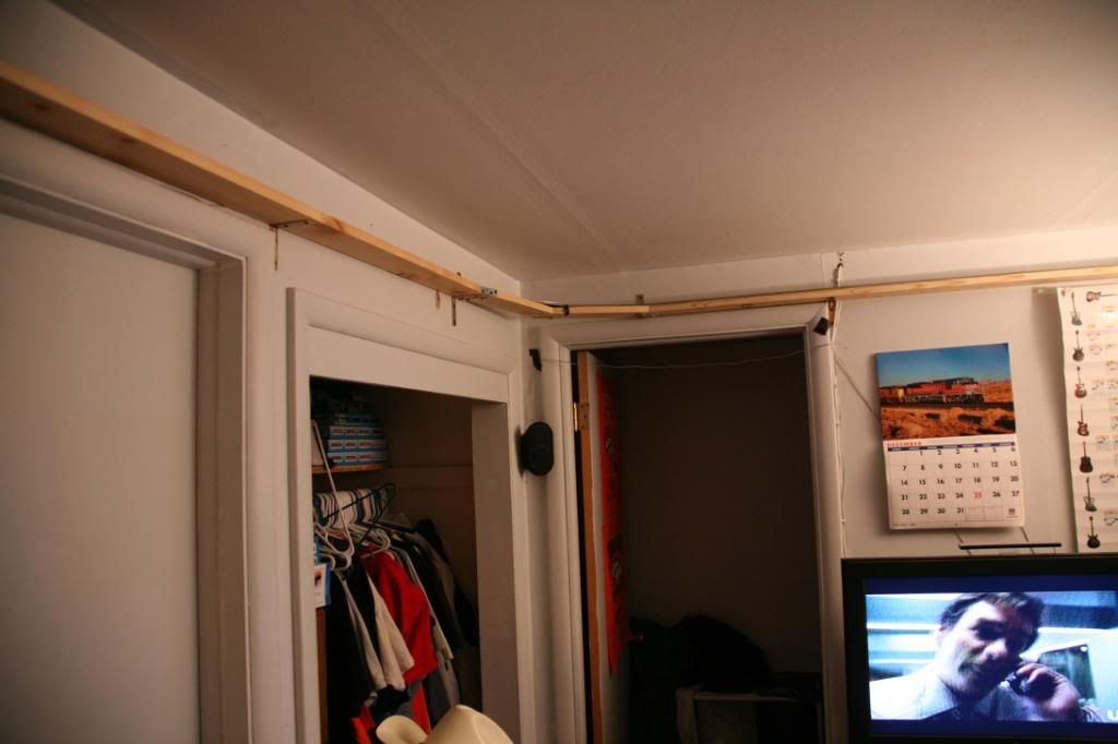

Do you have a pic of your shelf layout? I would be intrested to see it with the EZ Track.

I was gonna paint it black, but I just haven’t gotten to it. It is not attached at all, and I just really use it for testing equipment. I have some weird grades on it and the cars that roll really good tend to roll away on me.
