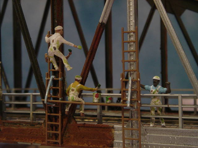

This is my Moose Bay Bridge. You don’t have to rust it out as heavily as this, but you can:

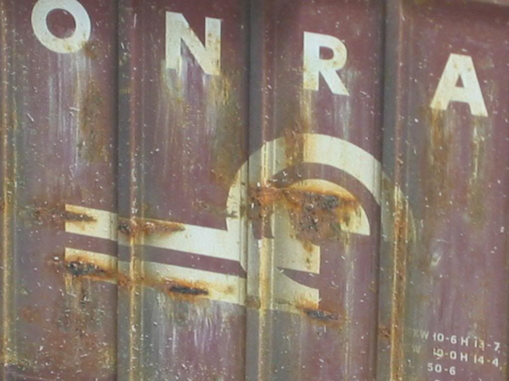

Thanks for the input. That boxcar looks fantastic.Are all the rusting spots done with sophisticated finishes alone or a mix bag of tricks?
