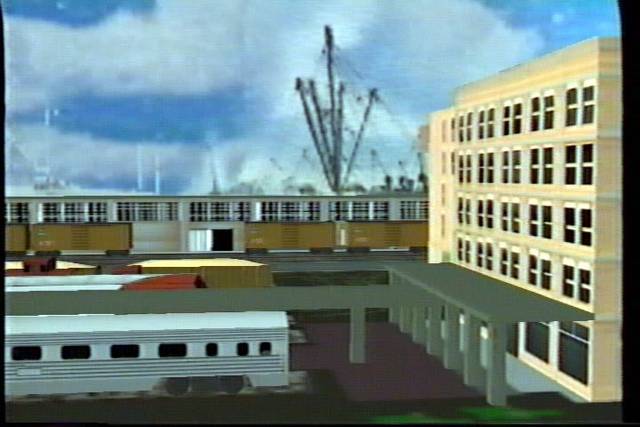

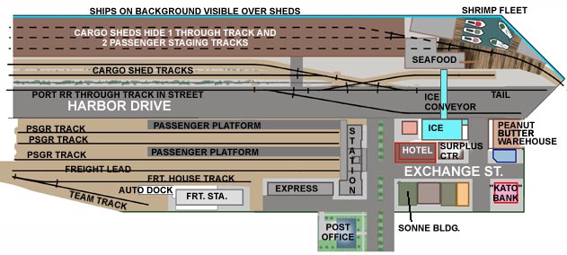

I am building an N layout with staging 1 ½" from background, but track is not visible there. Will be hidden inside long port warehouse buildings.
The center-line of the farthest-back visible track will be only one inch from front of the warehouse, but that is a loading track, up against loading doors. Upper portion of ships half a block away (supposedly) visible over tops of warehouse sheds.
It is nice to have more spacing, but where the “backest” track has something in front of it, and a background integrated with the closer scene, space almost zero can work. In the middle picture of the set below, the painted background is 1 ½" behind the center line of the track on which the switcher runs.
Oops. Shadow of the water tower falls on the BG. Oh well…
